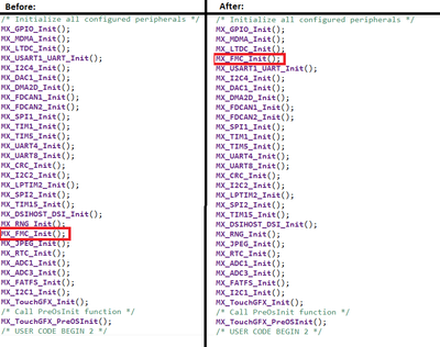

Hello @Osman SOYKURT,
it turned out that the problem wasn't gone yet, it still sometimes happened. Fortunately now we think we finally fixed it, there was a wrong order of initialization – in main, MX_FMC_Init() must be called before MX_DSIHOST_DSI_Init().
When LTDC error interrupt is enabled, during initialization after every start, LTDC error handler is called and Transfer Error flag is set. When the black screen problem happens, error interrupt is called second time in FMC initialization and LTDC FIFO underrun flag is set. After the reorder neither happens.

2024-05-15 4:16 AM - edited 2024-05-15 4:17 AM
