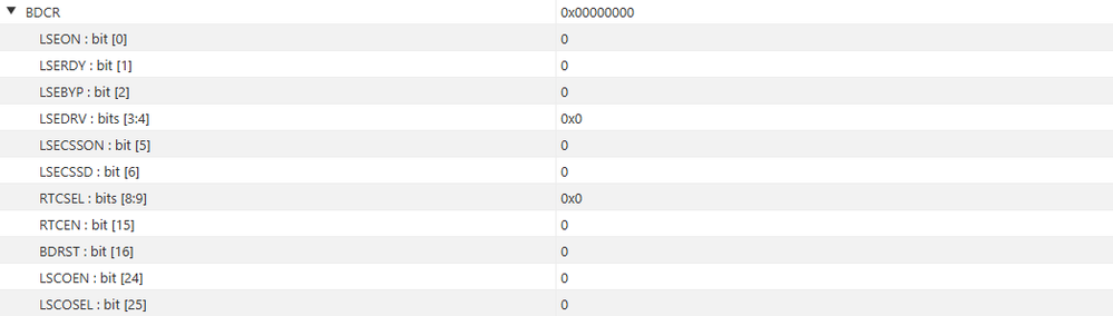

I would like to ask you to do one more experiment: in the "failed" state, i.e. when HSE does not work, can you please read out content of RCC_BDCR register and post it.
Thanks,
It actually stays the same when HSE is ok, changing VBAT leads to the same content of BDCR
