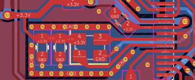

How is the oscillator connected, exactly?
2 capacitors there are 100nF and 1nF respectively.
I already tried cutting enable trace (floating enable = working oscillator) or using an external waveform generator. All approaches yield identical results.
