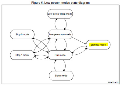

2025-08-18 1:23 AM - edited 2025-08-18 1:26 AM
Hi @STOne-32 ,
I apologize for the confusion. Please replace all my "sleep" term by "low-power".
When I wrote STANDBY, I explicitly spoke about the STANDBY mode. This is why I am confused because in that mode, I expected all the power sources to be off except for the WDT and the RTC...
I did not investigate much more about the STOP mode because they seemed out of scope for my project purpose (looks like the STANDBY is able to reach the lowest current consumption, am I wrong?).
From RM0454, I am trying to reach this STANDBY mode (which is working if I am only using my "sleep.c" file and reaches the target of ~2uA. Not working anymore if I first execute the piece of code "run.c" before "sleep.c"):
