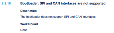

Also, the STM32L471xx errata sheet states that SPI interface is not supported in bootloader mode for this device:
Therefore, I suggest that you use another interface for this device.
With regards

I understand that SPI in bootloader mode is not supported but it's still driven by DMA, it keeps MISO line HIGH level in that mode, and there is no way to disable SPI interface. I had not read that application note you mentioned.
