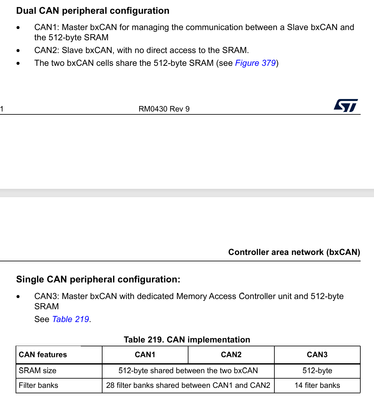

2025-07-26 1:03 PM
The differences between the three CAN instances are listed here:

2025-08-18 2:52 AM
Hello @erdinc ,
You can use the three CAN instances independently.
CAN3 is a standard CAN 2.0B interface exact replication of CAN1 and it is independent from CAN1/CAN2. CAN2 is slave to CAN1 from architectural point of view (not from protocol standpoint).
Hope that answers your question.
