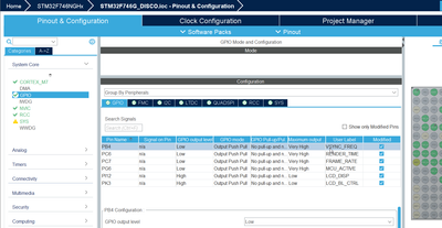

This TBS is configured for 272 x 480 pixels 16bpp screen resolution.
Performance testing can be done using the GPIO pins designated with the following signals: VSYNC_FREQ - Pin PB4(D3), RENDER_TIME - Pin PC6(D1), FRAME_RATE - Pin PC7(D0), MCU_ACTIVE - Pin PG6(D2)
It seems we are already using the PB4 pin.
What you can do it to use another pin or to change assign VSYNC_FREQ to another free pin.
To assign VSYNC_FREQ to another pin, open STM32CubeMX and check here:

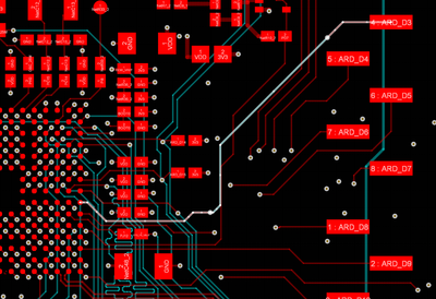

2025-07-07 11:57 AM
Dear Gaetan Godart,
I am not using the default pin configuration, I created a custom *.ioc file, see the attached file in my question.
I also checked the MB1191 design files, BGA pin A9 / PB4 / I2S2_WS is exclusively attached to the arduino header D3 pin:

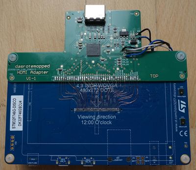

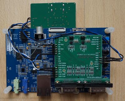

I am not using the onboard TFT:
I am using a custom Arduino shield to use I2S
