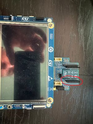

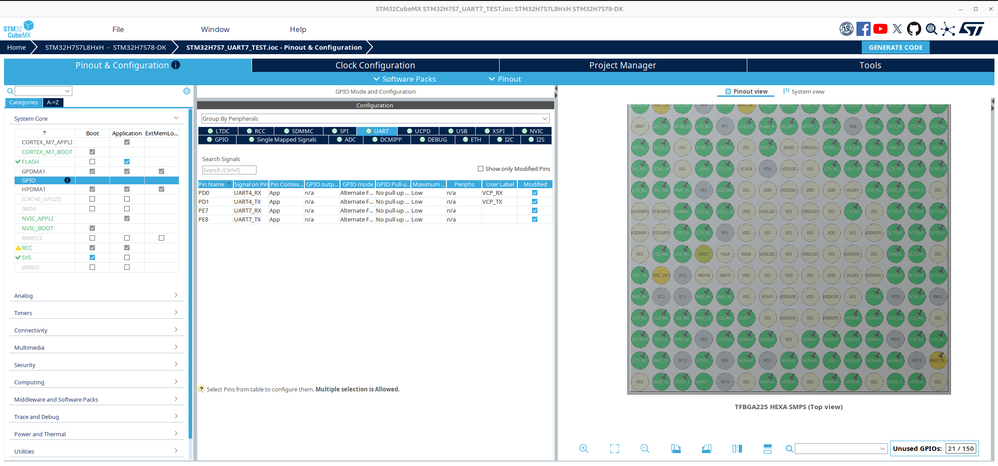

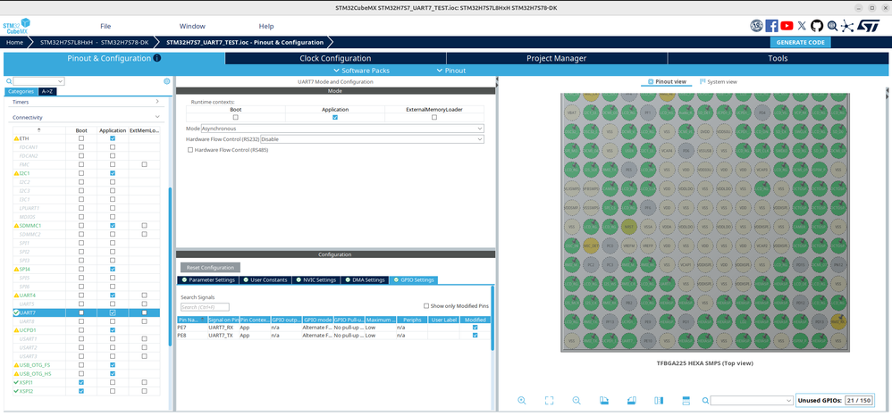

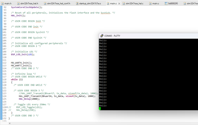

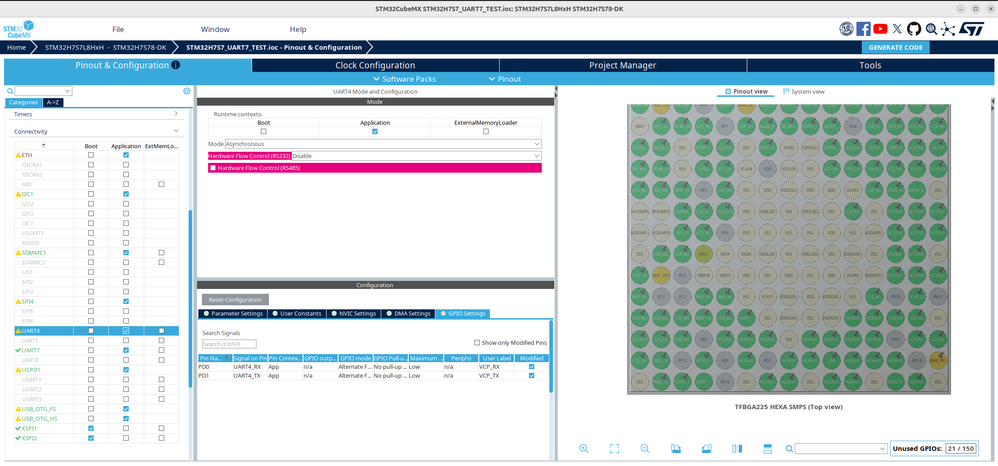

I am trying to develop a GUI application with the STM32H7S78-DK. I want to send uart data from the board over wires to a raspberry pi. To simplify the process without graphics I'm just trying to send a simple "Hello" string over UART7. From what I can see from the data sheet, UART7 is connected to pins PE7 and PE8, which correspond to D0 and D1 on CN14 on the arduino headers by default. Please correct me if I am wrong. So I first am just initializing those pins with uart on STM32CubeMX then I was just sending a simple HAL_UART_Transmit() with a 2 second HAL_Delay(). However, I see no data coming through when putting a logic analyzer on those pins. What am I doing wrong?
Here is the very simple basic uart code in main.

Hello @cbarb2747
I confirm that, on my side, both UART4 and UART7 are working correctly on the STM32H7S78-DK board.
UART7 is mapped to pins PE7 (RX) and PE8 (TX), and they are routed to connector CN14, signals D1 (RX) and D0 (TX).
Please find attached the main.c and stm32h7rsxx_hal_msp.c files that I used for this test.
These files include the UART initialization and pin configuration currently working on my setup. You can use them as a reference

UART7 is not working with the arduino pins. However, I can't get even UART4 to print to the putty terminal. Which uart4 should just be uart through the stlink which powers and flashes the code to the board. Here is the fresh code with a brand new project. I used STMCubeMX to initialize uart7, but all the other peripherals are initialized to their default values. I am able to very simply do the same process with an NUCLEO-L476RG and print to the uart via the stlink. Not sure what is going on with this board stm32h7s78-dk.
Here are the config setups
I have soldered jumper bridges to route the uart to the stmod+ connector and de-soldered the standard bridges to unroute spi coming out of the stmod+. And I am trying to get uart out of the expansion board connected to the stmod

* @brief UART4 Initialization Function
* None
* @retval None
static void MX_UART4_Init(void)
/* USER CODE BEGIN UART4_Init 0 */
/* USER CODE END UART4_Init 0 */
/* USER CODE BEGIN UART4_Init 1 */
/* USER CODE END UART4_Init 1 */
huart4.Instance = UART4;
huart4.Init.BaudRate = 115200;
huart4.Init.WordLength = UART_WORDLENGTH_8B;
huart4.Init.StopBits = UART_STOPBITS_1;
huart4.Init.Parity = UART_PARITY_NONE;
huart4.Init.Mode = UART_MODE_TX_RX;
huart4.Init.HwFlowCtl = UART_HWCONTROL_NONE;
huart4.Init.OverSampling = UART_OVERSAMPLING_16;
huart4.Init.OneBitSampling = UART_ONE_BIT_SAMPLE_DISABLE;
huart4.Init.ClockPrescaler = UART_PRESCALER_DIV1;
huart4.AdvancedInit.AdvFeatureInit = UART_ADVFEATURE_NO_INIT;
if (HAL_UART_Init(&huart4) != HAL_OK)
Error_Handler();
if (HAL_UARTEx_SetTxFifoThreshold(&huart4, UART_TXFIFO_THRESHOLD_1_8) != HAL_OK)
Error_Handler();
if (HAL_UARTEx_SetRxFifoThreshold(&huart4, UART_RXFIFO_THRESHOLD_1_8) != HAL_OK)
Error_Handler();
if (HAL_UARTEx_DisableFifoMode(&huart4) != HAL_OK)
Error_Handler();
/* USER CODE BEGIN UART4_Init 2 */
/* USER CODE END UART4_Init 2 */
* @brief UART7 Initialization Function
* None
* @retval None
static void MX_UART7_Init(void)
/* USER CODE BEGIN UART7_Init 0 */
/* USER CODE END UART7_Init 0 */
/* USER CODE BEGIN UART7_Init 1 */
/* USER CODE END UART7_Init 1 */
huart7.Instance = UART7;
huart7.Init.BaudRate = 115200;
huart7.Init.WordLength = UART_WORDLENGTH_8B;
huart7.Init.StopBits = UART_STOPBITS_1;
huart7.Init.Parity = UART_PARITY_NONE;
huart7.Init.Mode = UART_MODE_TX_RX;
huart7.Init.HwFlowCtl = UART_HWCONTROL_NONE;
huart7.Init.OverSampling = UART_OVERSAMPLING_16;
huart7.Init.OneBitSampling = UART_ONE_BIT_SAMPLE_DISABLE;
huart7.Init.ClockPrescaler = UART_PRESCALER_DIV1;
huart7.AdvancedInit.AdvFeatureInit = UART_ADVFEATURE_NO_INIT;
if (HAL_UART_Init(&huart7) != HAL_OK)
Error_Handler();
if (HAL_UARTEx_SetTxFifoThreshold(&huart7, UART_TXFIFO_THRESHOLD_1_8) != HAL_OK)
Error_Handler();
if (HAL_UARTEx_SetRxFifoThreshold(&huart7, UART_RXFIFO_THRESHOLD_1_8) != HAL_OK)
Error_Handler();
if (HAL_UARTEx_DisableFifoMode(&huart7) != HAL_OK)
Error_Handler();
/* USER CODE BEGIN UART7_Init 2 */
/* USER CODE END UART7_Init 2 */

Hello @cbarb2747
