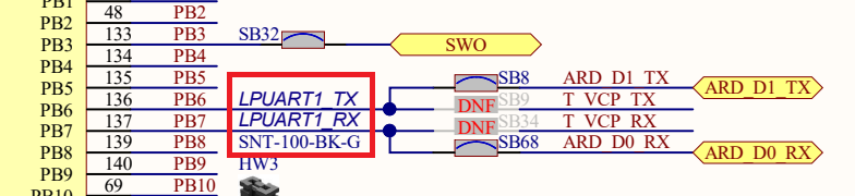

As i see in board circuit : on PB6/PB7 is not usart1 , but LPUART1 .

As shown in the table 21: D0 D1 are used for LPUART1 and not USART1:
From the board schematic:
So you can use USART2 on PD5/PD6 GPIOs:
