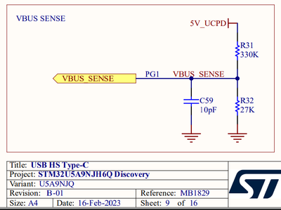

Hi @nico23
Did you check the pin used for vbus sensing in your software.  According to schematics, it is connected to PG1

nico23
Senior III
Hi @FBL
thanks for the headsup, and I've finally figured out what was wrong.

The problem wasn't here tho.
For some reason, disabling the VBUS sensing makes the interrupt fire correctly. Having  hpcd_USB_OTG_HS.Init.vbus_sensing_enable = ENABLE; was the issue. Changing to  hpcd_USB_OTG_HS.Init.vbus_sensing_enable=DISABLE; fixed it.
Now, the main issue remains.
Why does enabling the VBUS sensing make the interrupt on the USB-C port not work?
(The code on GitHub is updated; it doesn't work after attaching a USB to the USB-C port because it fires a hard fault as no descriptor for the USB device is configured but my main goal was to check if the interrupt was working)
FBL
Hi @nico23
Best regards,
FBL
