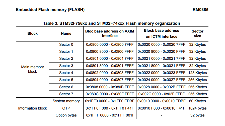

The datasheet for the STM32F746VET shows that it has 512k bytes of Flash. But the Reference Manual for the STM32F74xxx shows 1Mbyte of Flash (sectors 0 thru 7). Do we just assume that sectors 6 and 7 don't exist? This seems a bit vague.

Same die, same organization, different amounts final tested.
There is an OTP memory location with the size recorded, 16-bit wide, count in KB
