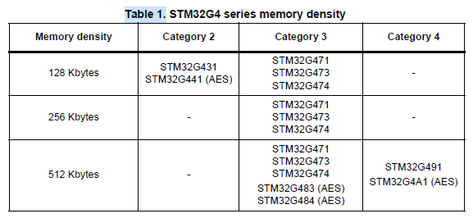

The G491KCU6 part has 256 KB flash. The G4A1KEU6 has 512 KB. Ref man (Table 1) has
No mention of 256 KB G491 part. Is it category 4?

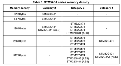

I think you are using an old version of the doc. The last version of the RM0440 (Rev 9) mention the 256KB STM32G491:
Best Regards.
Best Regards.
