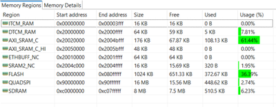

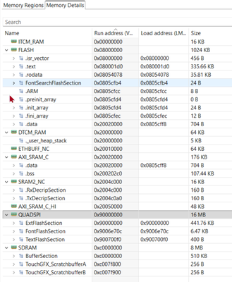

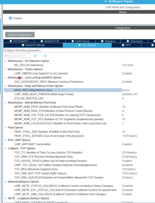

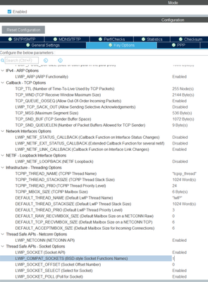

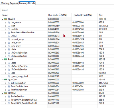

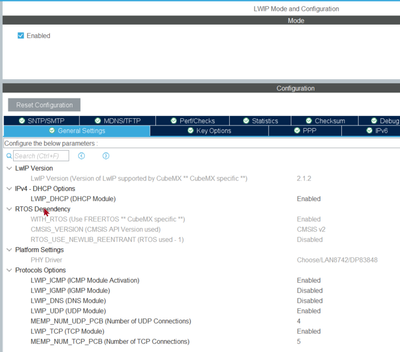

Hi @mbarg.1
thank you so much for your response and supporting me. Yes, I have update few inputs in "lwipopts.h" file but i am currently not sure about the configuration. It would be really appreciated if there is any standard configuration for Lwip Ethernet that works with stm32f746NGHS discovery board. Pleae
/* USER CODE BEGIN 1 */
#define LWIP_TCP 1
#define LWIP_NETCONN 1
//#define LWIP_DHCP 1
#define LWIP_DNS 1 // handy for MQTT later
#define LWIP_NETIF_HOSTNAME 1
#define LWIP_MDNS_RESPONDER 1 // mDNS (.local)
#define LWIP_IGMP 1 // required for IPv4 multicast 224.0.0.251
#define LWIP_NETBIOSNS 1 // optional: Windows NetBIOS name
#define LWIP_NUM_NETIF_CLIENT_DATA 1 /* required by mDNS */
#define LWIP_SO_RCVTIMEO 1
#define LWIP_AUTOIP 0
#define LWIP_DHCP_AUTOIP_COOP 0
#define LWIP_MQTT 1
#define TCPIP_THREAD_STACKSIZE 3072
#define DEFAULT_THREAD_STACKSIZE 1536
#define MEM_SIZE 16*1024
#define PBUF_POOL_SIZE 16
#define PBUF_POOL_BUFSIZE 1536
#define LWIP_RAM_HEAP_POINTER 0x2004C140
/* USER CODE END 1 */
I am adding screenshots ioc information and manual changes in code for reference for better understanding.
I assume DMA Rx and Tx buffer and DTCM non sharable and non cacheable are causing problem.
Stm32f746 host device updated NET link up but when i tried to ping on laptop I get host unreachable. this is due to DMA bufferes are not recognized or dont have memory is not handled properly.
Any further suggestions would be really appreciated.

The below images wherer i have update my memory for DTCM, SRAM1 and SRAM2 at the end either the TougchGFX freeze or hard fault error or sometime i can't run other applicaitons
Thank you.
