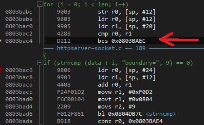

This is the exact place where it happens:

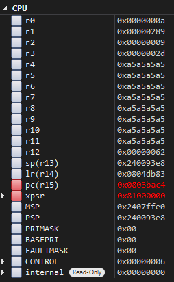

And this is a state of the MCU just before Hard Fault:
