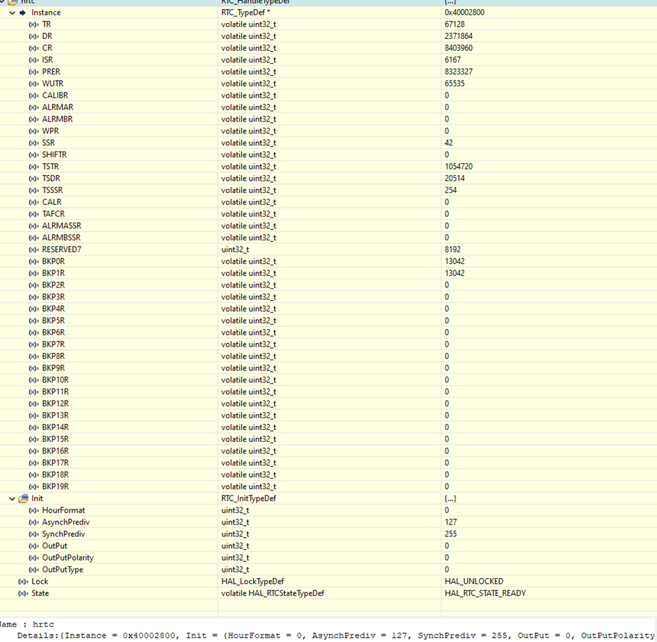

Here what hrtc struct shows:
This is after the jump. Before the jump only TR (1202225 = 0x125831) and SSR (82) are different. Time Register seems to be OK.

Decimal printout of registers is not very useful.
You haven't shown a hour transition: 65817 is 01:01:19 and 67128 is 01:06:38.
As I've said above, in the 12h timekeeping (i.e. when you have RTC_CR.FMT=1, as you do have in your setup), you have the following transitions:
11:59:59am +1sec = 12:00:00pm (noon)
12:59:59pm + 1sec = 01:00:00pm (13:00:00)
11:59:59pm + 1sec = 12:00:00am (midnight)
12:59:59am +1sec = 01:00:00am (01:00:00)
and this explains what you've posted in your initial post, i.e. it's counterintuitive but completely OK.
PS. You have RTC_CR.DCE=1. Do you really use the Coarse calibration?

You think that I have RTC_CR.FMT = 1?
Where do you see it?
Is it 8403960 = 0x803BF8 above at the "CR" line?
I have corrected the TR before the jump above, I have been too slow in the debugger and copied the value after the jump. Now it is TR = 1202225 = 0x125831 which is 12:58:31.
I don't use coarse calibration. But this will not be the problem here?
Yes.
And, as I've said already, 12:59:59am +1sec = 01:00:00am so that's normal.
As you are surprised by this bit being set, it's quite likely that the FMT bit has been set inadvertently, too (and I'm willing to bet that some of the other CR bits, too). Often it's consequence of using uninitialized local variables.
