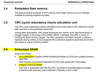

For STM32F429, the total embedded SRAM size is 256 Kbytes and 4 Kbytes of backup SRAM.
So, you need to check if the frame can be located in the internal SRAM or the size of frame buffer exceeds the internal SRAM size. Note that the double frame buffer calculation depends on color depth and display.

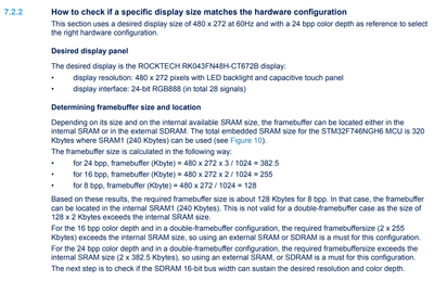

For that, I recommend you to take a look at AN4861 precisely 7.2 Example: creating a basic graphical application.
This section provides an example based on the STM32F746G-DISCO board, describing the steps required to
create a basic graphic application and explains how determining framebuffer size and location.

I advise you to start with an available example like as LTDC_Display_2Layers in STM32CubeF4 and get inspired to create your own project.
Also, I think 7.2 Example: creating a basic graphical application section in AN4861 can help you.
