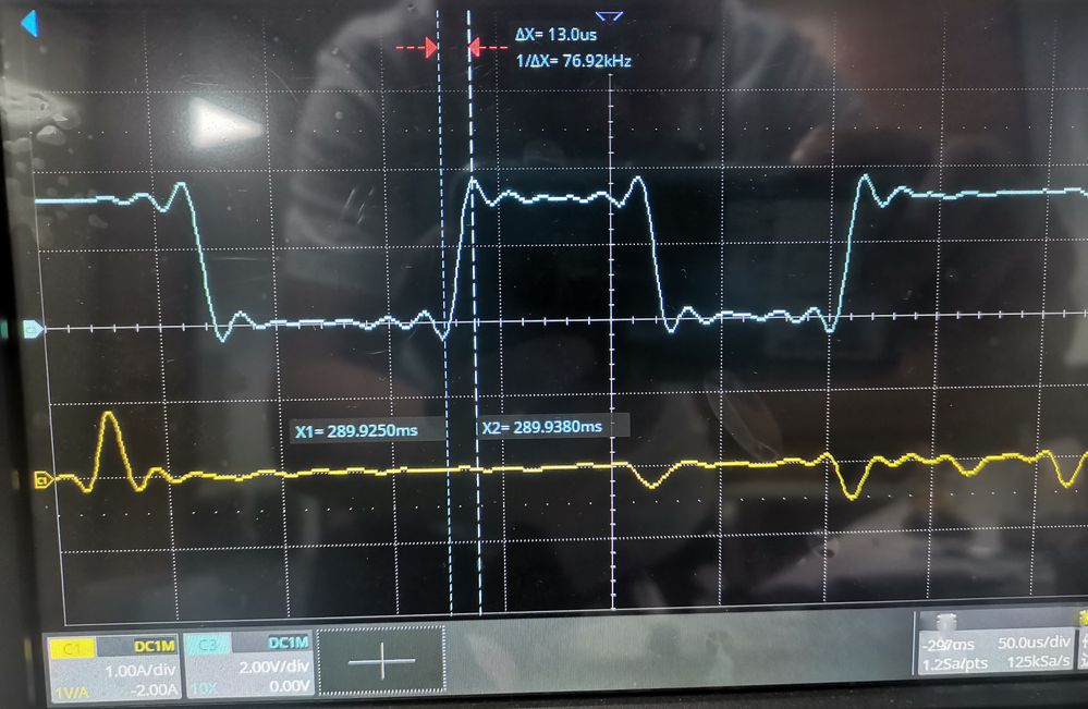

I'm doing motor drive project and its six pwm signals output from F429 connect with drive IC-- DRV8302 directly, but pwm rises and drops lowly (above 10us) as attached picture. I think this rising time takes too long,is right?
Thank you.
2021-10-15 3:21 AM
Check the relevant pins' "drive" setting in respective GPIO_OSPEEDR.
2021-10-26 11:48 PM
OK, thank you again @Community member
