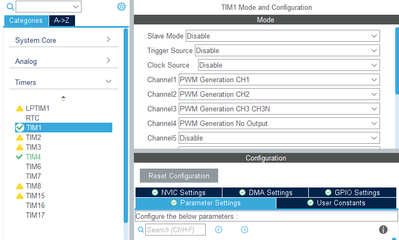

2025-11-14 1:49 AM
I am not sure how you are generating the code etc, but see if the below CubeMx settings are useful
It is giving an option to generate complementary or independent, verify if it is useful.
