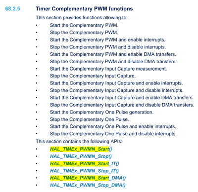

Here's a working example:

that worked, but I am now confused, I read this in the HAL documentation:
HAL_TIM_PWM_Start(...... and that seems to work to start the OC1 output while
HAL_TIMEx_PWM_Start( ........ gives an error.
Why is it I use one syntax to start OC1 and another to start OC1N? I can find no mention in the HAL documentation about this other syntax. Do I have the best available Hal documentation:UM1905
Craig
2025-11-09 3:40 PM
I've found the Timer Extension Driver chapter......so it is included in the documentation that I had, but that I was not looking far enough afield to find it.
Thanks for your help.
Craig
2025-11-09 4:07 PM
This is not a HAL function and therefore does not appear anywhere in UM1905.
The correct function to use is still HAL_TIMEx_PWMN_Start, which appears in UM1905.
