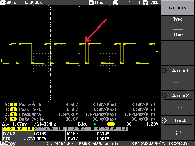

I compared the behavior of this chip with that of the STM32H743, which does not produce the extra bit.
The first image shows the timing when repeatedly transmitting the byte 0x0F at 9600 baud with 1 stop bit and no parity on the STM32H743 Nucleo board. Each byte is the expected size of ~1ms

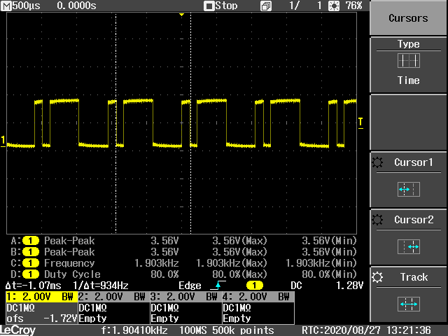

The image below is the same code running on the STMF413 Nucleo board with the same settings. The extra time can be seen at the end of each stop bit.
For both boards I generated code using STM32CubeMX with UART 2 enabled and added the following code in the main function:
uint8_t data = 0x0F;
while(true)
HAL_UART_Transmit(&huart2, &data, 1, HAL_MAX_DELAY);
}Any insight on why this behaviour is occurring? And are there any MCUs similar to the F413 that are known to not have this problem?
2020-08-27 10:42 AM
Don't transmit one by one, or don't use the Cube function which (quite correctly) waits until the last byte leaves the shift register.

2020-08-27 11:41 AM
What JW is suggesting is to still use HAL_UART_Transmit but with more than one byte at a time. This is not a hardware limitation. It is a result of the software and how you’re using it.
If you need tight, non-standard uart timing, you’ll probably need your own driver.
2020-08-27 6:25 PM
>What function would avoid the extra bit time when you have to send byte by byte?
Function written by you.
It's trivial to write. Wait until UARTx_SR.TXE is set, then write the byte into UARTx_DR.
For 485 steering, in 'F4 you'd need to wait for TXC be set after the last byte (after having cleared it before). Newer families such as 'F0 have an option to generate DE in hardware. Read the RM.
