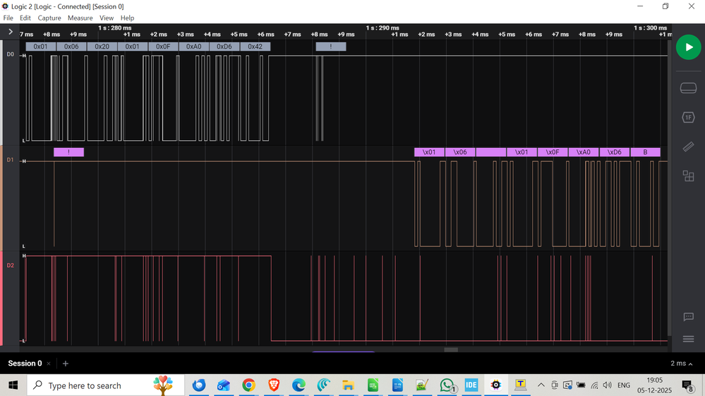

2025-12-05 5:59 AM
It works fine now. D0 is data sent by STM32 (Modbus RTU Master) and D1 is reply data from VFD and D2 is DE. Rewired and cleaned by merging with previous working code. Issue was probably with
1. Wiring of Rx signal from STM32 to MAX485 (TTL to RS485 board) and / or to VFD.
2. Delay
Updated code to send and Modbus RTU frame is:
tx_status = HAL_UART_Transmit(huart, request, 8, 100);
while (__HAL_UART_GET_FLAG(huart, UART_FLAG_TC) == RESET);
rx_status = HAL_UART_Receive(huart, response, 8, 200);
Thank you all for the inputs. Issue can be closed.

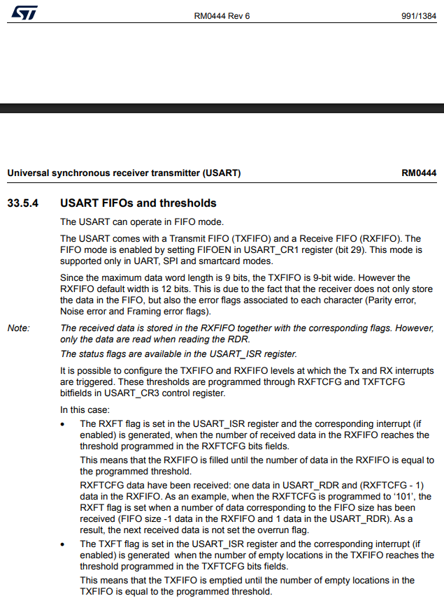

@arunachalamram wrote:What is the UART receive buffer size?
See the Reference Manual for details of the UART and its operation.
