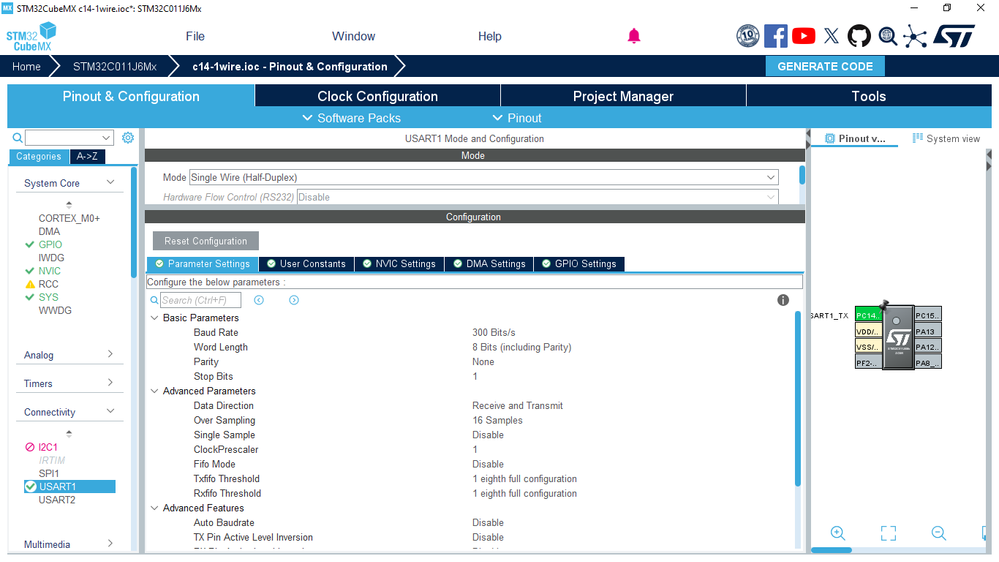

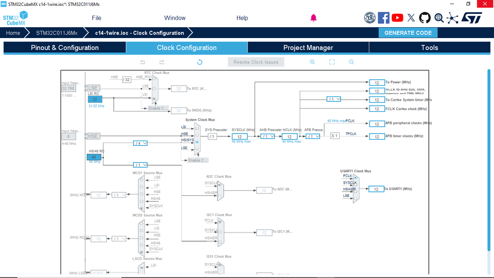

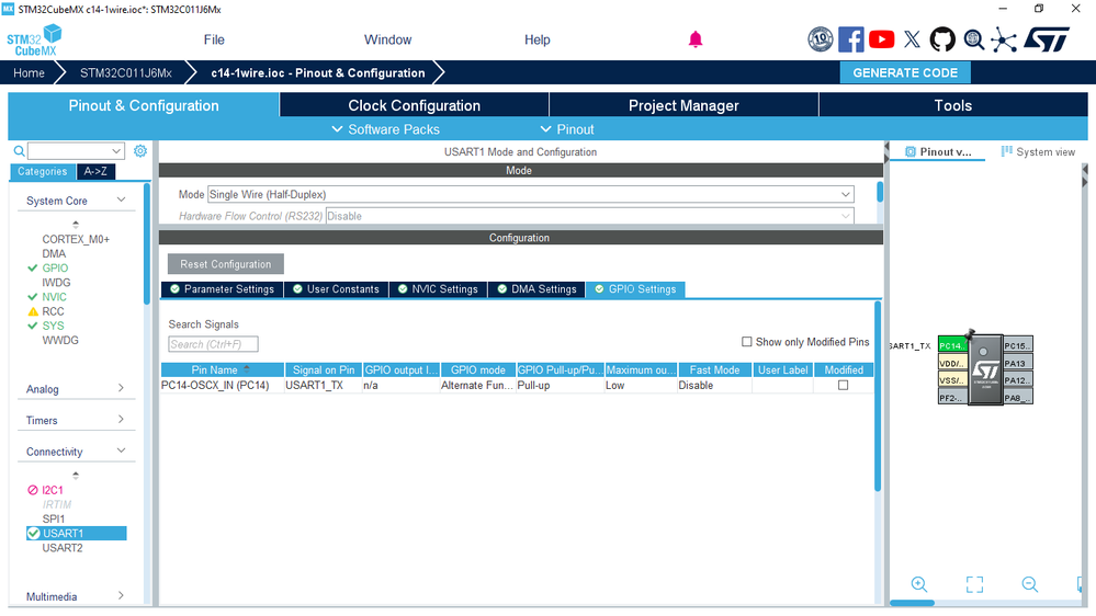

Need getting-started help with STM32C011J6M6 MCU and USART1 in single-wire Async mode (using STM32Cube toolchain and C language.)

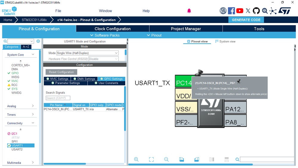

The hardware configuration is just  the STM32C011J6M6 MCU (8-pin SOIC package) with one pin (pin 1) pulled up (4.7K to 3.3V). Intent is to use this in single-wire Async mode to communicate with outside world. All other MCU pins have similar pull-up resistors but are not otherwise connected. Power to the MCU for this test is furnished by the STLINK device. The test is using programmed I/O (no DMA,  no interrupts.) The test program solely is written to experiment with the USART1 in single-wire mode on this device; there  are no other aspects being tested or included.
Tools in use:
IDE 1.19.0
MX 6.15.0
PROG 2.10.0
Used STM32CubeMX to generate code template (targeting STM32CubeIDE), STM32CubeIDE to build the example (C-language) program, and STM32CubeProgrammer to push the resulting (elf) binary to the device using STLINK attached to the  SWCLK/SWDIO and power pins.
When running, expected result is that async bytes will appear on pin 1 (active low, open drain). Actual result is that pin 1 remains held high by it's pull-up resistor.
I previously checked hardware using another short  program (same tools) to set the pin as GPIO (open drain) and then toggled the pin high/low (with delay in loop) to verify electrical behavior.
Four screen grabs from STM32CubeMX are attached, as is the main.c program being used  for this test (a single ZIP file contains the five small files.)

1. Is something (during initialization) not being enabled that should be enabled? (that is, does the code generated by STM32CubeMX expect the user to amend it to enable or power-up a key internal peripheral (such as Clock, GPIO or the USART)? (recall that I used the same method to verify GPIO output toggling is possible with no changes to the MX generated code other than adding the "toggle the pin" code.)
2. Does single-wire (USART) mode work when the CPU pin only has TX capability (for that peripheral)? Do I need to add/specify anything about the RX pin (which I believe  is not used nor enabled when in single-wire mode)? Pin 1 offers PB7/PC14-OSCX_IN, I am using PC14 (only) which supports USART1_TX, TIM1_ETR, TIM1_BKIN2, IR_OUT, USART2_RTS_DE_CK, TIM17_CH1, TIM3_CH2, I2C1_SDA, EVENTOUT). Note that while I am using single-wire mode (which I gather is based on a configuration of USART1_TX, the pin does not offer USART1_RX capability.
3. Are the instructions HAL_HalfDuplex_EnableReceiver(&huart1); and HAL_HalfDuplex_EnableTransmitter(&huart1); actually required in this use case? My prior work (bare-metal style) with STM32F103 and single-wire USART mode didn't have any sort of enable instructions involved; once configured the USART worked as expected (for both transmit and receive) provided that the application "knew" when it was allowed to send data.

Created a fresh clone of your project, but have only a STM32C0116-DK for testing. PC14 and PB7 are not bonded together in that larger package. I can see the UART output clearly on PC14.

Your result tells me that a separate declaration for the unused  _RX pin isn't the issue.
UFQFPN20 pin 20 (PC14-OSCX_IN) working also suggests to me that there's not a conflict with oscillator input alternate function.

Thank you again KnarfB - your workbench support of my problem illuminated the direction to proceed and saved much spinning-of-wheels!
Worked out the issue -- turns out the GPIO initialization routine generated by STM32CubeMX (at least the version I'm using) only turns on the required clock for the peripheral. I added instructions (seen below in the alternate GPIO_Init function) to support USART in 1-wire mode based on the hardware that is being used (external pull-up resistor on SO8 MCU pin 1 selected as PC14.)
static void MX_GPIO_Init_C14(void)
  /* GPIO Ports Clock Enable */
  __HAL_RCC_GPIOC_CLK_ENABLE();
  // New code added for support of USART1_TX in 1-wire async mode
  /*Configure GPIO pin Output Level */
  HAL_GPIO_WritePin(GPIOC, GPIO_PIN_14, GPIO_PIN_SET);
  /*Configure GPIO pin : PC14 */
  GPIO_InitStruct.Pin = GPIO_PIN_14;
  GPIO_InitStruct.Mode = GPIO_MODE_OUTPUT_OD;
  HAL_GPIO_Init(GPIOC, &GPIO_InitStruct);
  HAL_SYSCFG_SetPinBinding(HAL_BIND_SO8_PIN1_PC14);
  /* USER CODE BEGIN MX_GPIO_Init_2 */
  /* USER CODE END MX_GPIO_Init_2 */
Nice you figured that out. Your code is similiar to what's generated in my HAL_UART_MspInit (Src\stm32c0xx_hal_msp.c).
