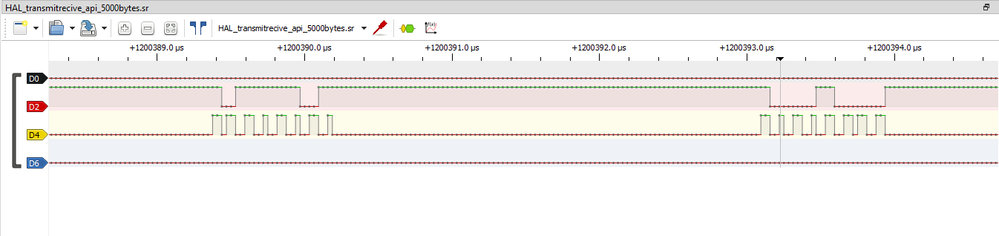

Logic analyzer observations
I then captured the SPI signals using a logic analyzer (PulseView .sr file attached can be opened in pulseview software).
Key observations:
  • The SCK is not continuous
  • The clock appears to be generated byte-by-byte
  • There is a noticeable gap between successive bytes, almost 2.9 us.
  • It looks like software is triggering the clock rather than the SPI peripheral running continuously (Please correct me if my interpretation is wrong.)

Yes, this is a well-known "feature".
@Zaeem-Ahmed wrote:
  1. Why is the official STM32 HAL SPI API unable to keep the clock running continuously at the configured 9 MHz? otherwise why would it offer 9Mhz?
The HAL source is available for you to inspect.
You will see that HAL_SPI_TransmitReceive() does quite a lot of work between the end of one byte* and the start of the next.
 You can improve matters by increasing the compiler optimisation level.
For maximum throughput, consider using DMA.
* Or whatever size transfer you are doing
@Zaeem-Ahmed wrote:
2. Is SPI clock generation strictly tied to writes to SPI->DR?.
Yes.
This is fundamental to the operation of SPI; not specific to STM32: there is exactly one clock per bit transmitted.
If no bit is transmitted, there is no clock.
