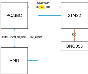

Desired Result
  • Stm32 read the Quaternion data via I2C
  • STM32 could send the Quaternion data to PC at default frequency, and the PC could send command (string) to the STM32 via USB VCP ,such turn on HMD, turn off HMD,  Brightness adjust, … … etc. the block structure is shown below

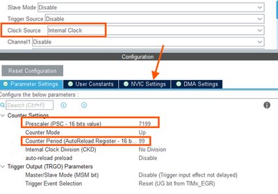

  • Page – Timers:
  • TIM2: Clock Source>>Internal Clock
    • Prescaler: 7199, Counter Period:99
    • NVIC Setting>>TIM2 global interrupt enable

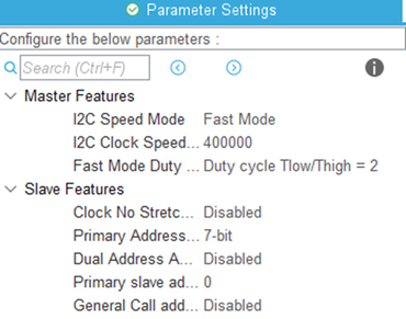

    • I2C1:I2C>>I2C (Fast Mode)

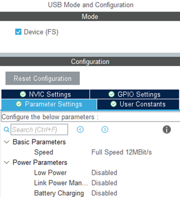

    • USB: Mode>>Device(FS) selected
  • Page – Middleware and Software Packs
    • USB_Device: Class for FS IP: Communication Device Class (VCP)

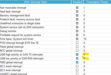

    • System Core>>NVIC>>Change the Preemption Priority from USB

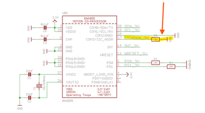

  • Purchase the Adafruit  9-DOF IMU  BNO055
  • Read/Write via the I2C

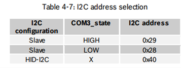

    • device address:0x28,COM3 pull low

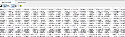

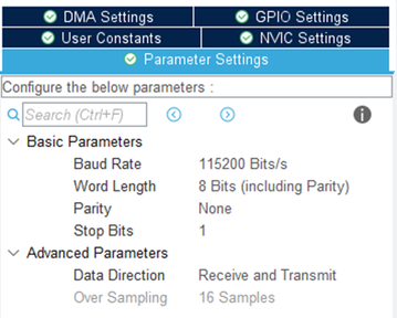

Test1- BNO055 Testing using UART
  • Use UART to transmit the data(Quaternion) from stm32 to PC to make sure the BNO055 is work or not
  • Options for target”xxxx”, in the target page, select the Use Micro LIB
  • Connect FT232 to USB module to STM32
    • STM32, PA9 TX-> FT232 RX
    • STM32, PA10 RX->FT232 TX
    • STM32, GND->GND
    • Connect the FT232 module and turn on the STM32
    • Open PC’s Device manager to find the COMPORT
    • Open COMPORT terminate software and connected the device start communicate
  • Result: Successful to Read the data from BNO055 and transmit these data to PC COM Portstevefeng_14-1770270845222.png

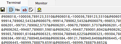

Test2- BNO055 Testing using VCP
  • Use VCP to transmit the data(Quaternion) from stm32 to PC to make sure the BNO055 is work or not
    • STM32, GND->GND
    • Turn on the STM32 with USB Cable
  • Result: Successful to Read the data from BNO055 and transmit these data to PC COM Portstevefeng_13-1770270834117.png

Test3 – STM32 Receive
  • In my HMD design, there have some commands need to use VCP to communicate PC with STM32. The STM32 needs to determine whether the string transmitted from the PC is a control command or not.
  • In the “usbd_cdc_if.c”>> CDC_Receive_FS function
  • in user code begin 6, add string judgement
  • In the main.c while loop
  • In user code 3, Add the judgement, as picture shown below
  • Result: Fail, PC could not send command to STM32 via VCPstevefeng_12-1770270794024.png

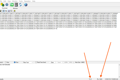

Test4 – STM32 Receive Trying
  • Test1: Comment the CDC_Transmit_FS((uint8_t*)msg, strlen(msg)), PC could send data to STM32
  • Test2: UnComment the CDC_Transmit_FS((uint8_t*)msg, strlen(msg)), PC could not send data to STM32
  • Test3: Add 1000ms delay after CDC_Transmit_FS((uint8_t*)msg, strlen(msg)), PC could send data to STM32, but this frequency could not realize the AR Anchor effect,(BNO055 default setting 100Hz, this setting will get the best Euler Angle for head mount display for human pose estimation, therefore, I hope to maintain this frequency)
  • Test4: Using the timer interrupt to limit the STM32 to PC’s send frequency, timer ISR: 72Mhz/7200/100 (F=100Hz) (T=10ms), the setting shown in the right-hand side, PC could not send data to STM32
