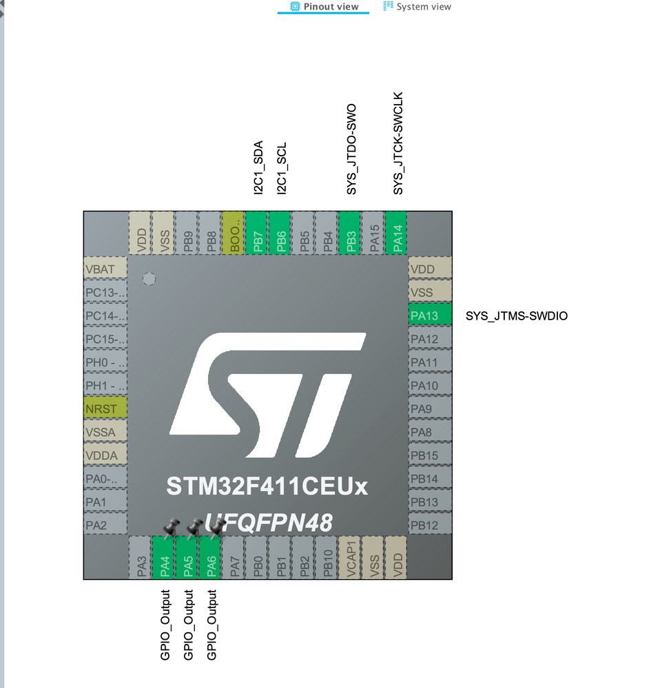

I set the SWD up for a project inculding a PCB with an F411CEU6 and an VL43L8CX. To test the pcb, I wana get the distance printed to the SWD console. I set up the SWD and with the main.c file it works fine, but with the vl53l8cx.c the printf statements don´t get printed...
Do you guys have an idea?

- The STM32F411 is on a costum PCB
- the VL53L8CX is directly soldered to the PCB
The LED from the PCB is blinking, and the programm is the first test with the new PCB, I was able to get some printf statements back from the chip -> Chip should work
Now i wanna try if the I2C Connection to the VL53L8CX is working, this is why I started this chat, because I hat problems with the debbuging / printf statements
This is the Pinnout of the StM32 chip:
Thanks for your patience!
