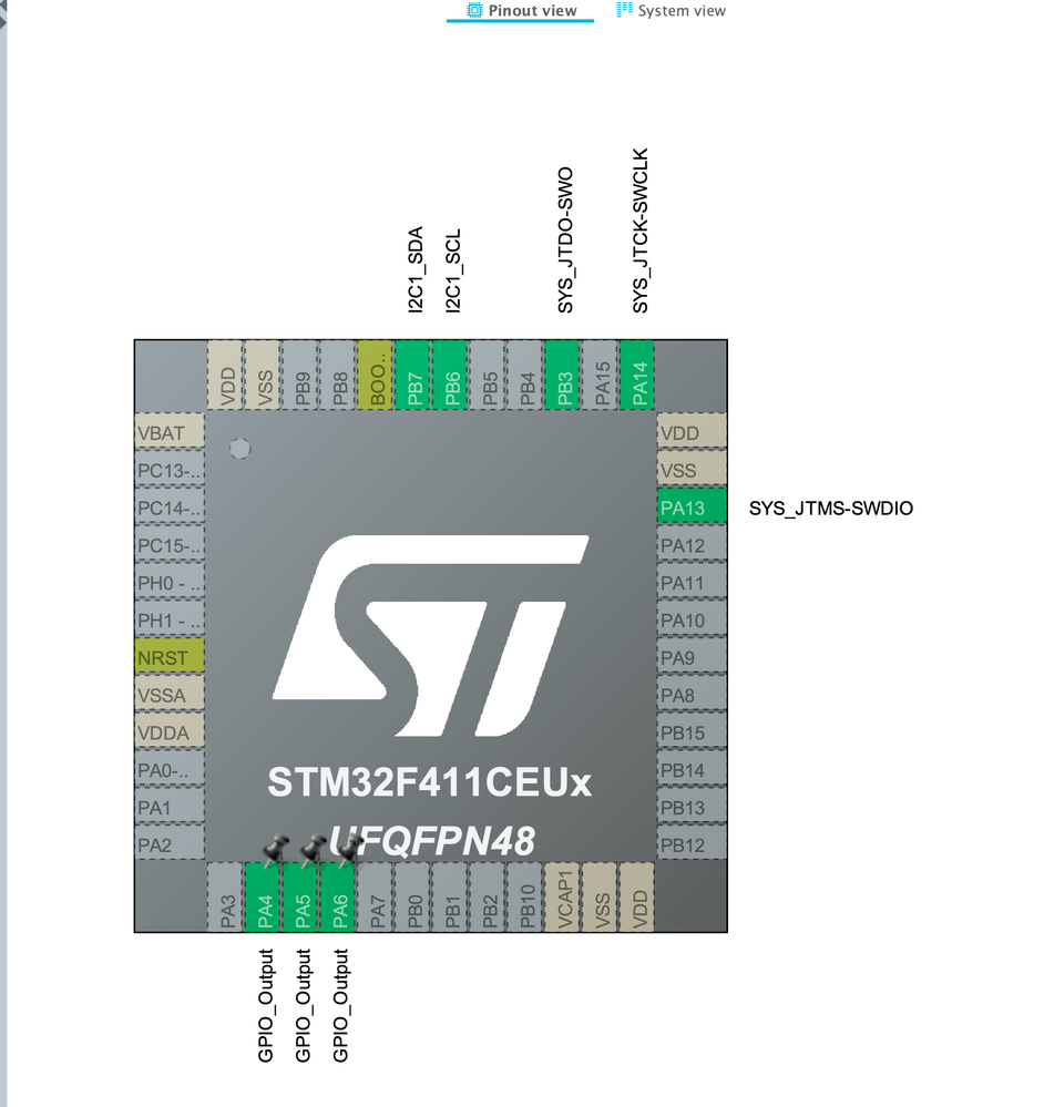

Thanks, for the answer. PB3 was actullay used for an gpio output so I changed that, but still not working in the vl53l8cx.c file...

This is the Pinnout:

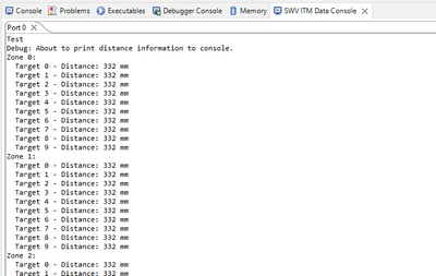

I confirm the printf through SWV is working everywhere. I just written the function below outside of main.c and force some constants values because I do not have ToF sensor in my hands today.
int32_t VL53L8CX_GetDistance(VL53L8CX_Object_t *pObj, VL53L8CX_Result_t *pResult)
Check again your firmware, call vl53l8 function from main and place some breakpoint in order to debug.
