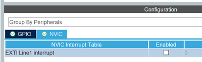

Hello guys.
I designed a custom board around the STM32F411CEU6. On this board, I have a switch and a screw terminal header, both of which are intended to be used has GPIO inputs. However, with both I've had a struggle working with GPIO inputs and interrupts. Attached is my current code, with my button being located on pin PA0. I intend to use pins PA1 and PA0 as input, with PA1 attached to a mat that activates similar to a switch.
What's more confusing is that my display and touch input does indeed work. In fact, even LVGL works on this microcontroller and display. It's only the GPIO interrupts and inputs that I have an issue with. I've also attached a picture of my schematic. Any help is appreciated!

2025-08-27 10:13 AM
I should add that my reset and boot switches work just as intended. There are no issues with those switches.
2025-08-27 10:19 AM
I've found that this code works when I'm not treating it as an interrupt. However, it still does not work with pin PA1 for the digital pressure mat I have.

2025-08-27 10:36 AM
Enable the interrupt by checking the box in the IOC file GPIO tab. There needs to be an HAL_NVIC_EnableIRQ call to enable the EXTI interrupt for that pin.
Attach your IOC if you're still having trouble.
