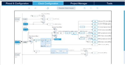

Hi everyone,
I’ve designed a custom PCB using the STM32F411CEU6 and a USB-C connector, but my laptop (Device Manager) and STM32CubeProgrammer fail to detect it as a DFU device or CDC. The board powers up (3.3V LDO confirmed working), and basic SWD flashing works, but USB fails.
USB-C Schematic:
CC1/CC2: 1kΩ pull-downs to GND (per USB 2.0 Type-C specs).
D+/D-: Connected to PA11/USB_DM and PA12/USB_DP.
VBUS: Filtered through a ferrite bead (BLM21AG121SN1D) and 2.2µF decoupling caps.
Boot Configuration: BOOT0: Pulled to GND via 10kΩ resistor (tested pulling high during reset).
Clock: 8MHz crystal with 30pF load capacitors.
DFU Entry: Tried BOOT0=1 + reset (via button). Get that the "USB device not recognised."
I have attached my schematic and the clock configuration for reference.

CCx lines pulldowns are usually 5k1. Check the power supply voltage and the operation of HSE oscillator with the oscilloscope. With BOOT0 = 1 the MCU should be detected by CubeProgrammer as DFU.

Hi @Niharika
To better understand the issue, could you provide a detailed description of the problem? Do you reproduce the issue on a reference board? Is your device self-powered?
