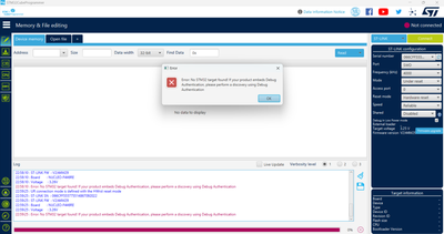

Hello again,
Vdd on the ST-link is 3.38V and this is what i got in the CubeProgrammer:
Should i just give up and replace the chip when i get some stock? it doesn't seem dead to me but it's driving me crazy why can't I connect to it!!
2024-04-19 12:25 PM
it tells :
So what you use here ? a st-link ? or a nucleo-F446 board ??

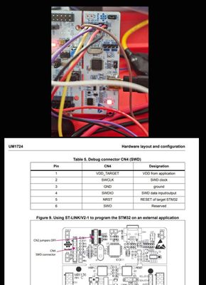

2024-04-19 1:03 PM - edited 2024-04-19 1:08 PM
I'm using the st-link part of the nucleo board (stm32F446RE) (and it'sworth mentioning that the actual chip F446 is not on the board anymore after it got burned few weeks ago) ,, I read in ST's application note (UM1724) that there are two jumpers i can take them off and use the St-link to program external chips by the SWD header
And as i mentioned in one of the previous replies, that using the same method successfully identified the stm32f103 on a bluepill board with no issues.
