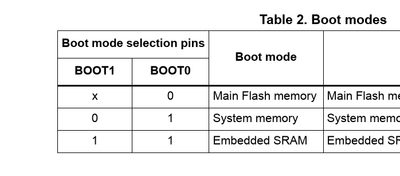

boot1 floating ... why ??
So you can not use bootloader, boot0 has to be low .

I've soldered a wire and i pulled boot1 low through a 10k resistor.. and then tried to pull it high .. but with the same result.. would this mean that my chip is dead?
Would it be dead even if i see the reset pin voltage as expected and both vcaps1&2 showing proper voltage? What do you think is the issue here?

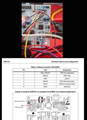

I did miss up the swd pins.. however i connected the wires one by one (out from the adapter) to the st-link section of a Nucleo board (I tested this to identify a bluepill board which it did successfully).. and i tested with a continuity test from every single pin to the swd header on the Nucleo board
then i tried with my custom board but it didn't work.. it's very frustrating

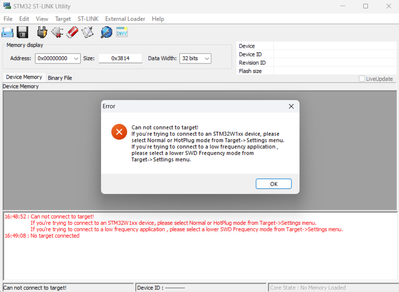

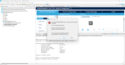

Regarding the CubeProgammer, I'm sorry but i can't seem to find a place to download this anymore! Any ways I attached screenshots from st-link utility, and from the CubeIDE, as well as the application note and connections i used to recruit my Nucleo board's st-link as a programmer (which i tested successfully for a BluePill board (an stm32F103)).

So, st-link utility is old and deprecated. Not useful - dont use it.

Message in IDE helps nothing - just it cannot "see" any target. (Always same message - if not working.)
