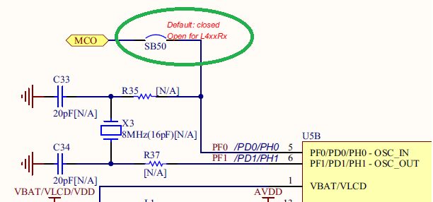

Clock is probably provided by the ST-LINK:
There are four ways to configure the pins corresponding to the external high-speed clock (HSE):
MCO from ST-LINK (Default):
MCO output of ST-LINK is used as input clock. This
frequency cannot be changed, it is fixed at 8MHz and connected to the
PF0/PH0-OSC_IN of STM32 microcontroller. The configuration must be:
SB148 OFF
SB112 and SB149 ON
SB8 and SB9 OFF
HSE on-board oscillator from X3 crystal (not provided):
2018-04-11 10:07 PM
On nucleo board, STM32F103 from ST-Link outputs 8MHz frequency, connected to HSE_IN pin on STM32F446. If you wish to use HSE in this mode, select Bypass clock source mode in HSE configuration in CubeMX.

Hi
vassilisamir
,The boards marked MB1136 C-02 (or higher) corresponds to a board, configured to use ST-LINK MCO as clock input.
This frequency is fixed at 8 MHz and connected to PF0/PD0/PH0-OSC_IN of the STM32 microcontroller.Khouloud.

Hey,
I'm using the NUCLEO64 F446RE and I disabled the MCO signal by desoldering SBs and cut both part of the board. I only want to keep the STM32F4 part.
Then I soldered a 8MHz osc on X3 (and added the corresponding capacitors and resistors), but it doesn't oscillate... Are, the OSC_IN and OSC_OUT pins enabled by default ?
If anyone can help me, i would really appreciate that.
Thank you,
Zephyr
2019-03-27 8:59 AM
If you can go in debug mode, then run the code, stop (breakpoint) and look at the HW registers settings (PLL, RCC, etc...) to understand in which configuration you really are.
You could also use the debug watch register window to activate MCO pin manually and look at internal clocks + scope probing.
