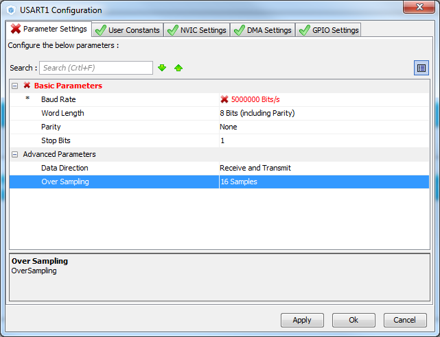

Highest baud rates values require to have Oversampling set to 8 (not 16).
Using an APB2 clock at 60 Mhz, with an USART oversampling set to 16, max baud rate that could be achieved is corresponding to 60/16 = 3.75 Mhz, so more or less what you experienced. Could you check Oversampling setting value when configuring your USART in Cube MX (8 or 16) ? If 16, could you try 8 instead?Best regards

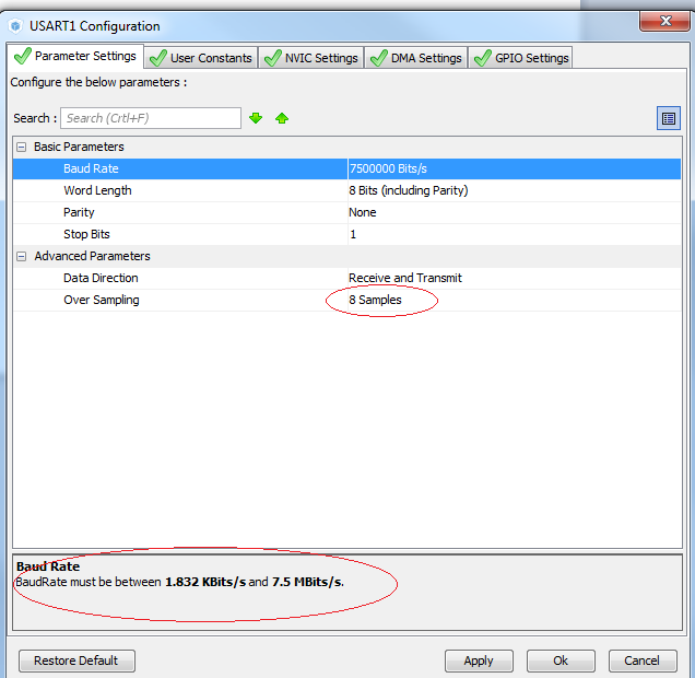

Just some pics to highlight what i meant :
Here is CubeMx configuration window when trying to apply 5Mhz baudrate using OverSampling rate set to 16 samples :

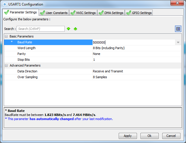

Now, selecting oversampling 8, extends possible baudrate range and allow reaching 5Mhz :
Regards
