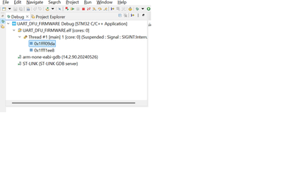

after running my project ,as suggested by the document the Debugger suggest that my MCU is inside System Memeory (0x1fff0000).but i still get timeout error.
Is there any hardware change required for Nucleo board
