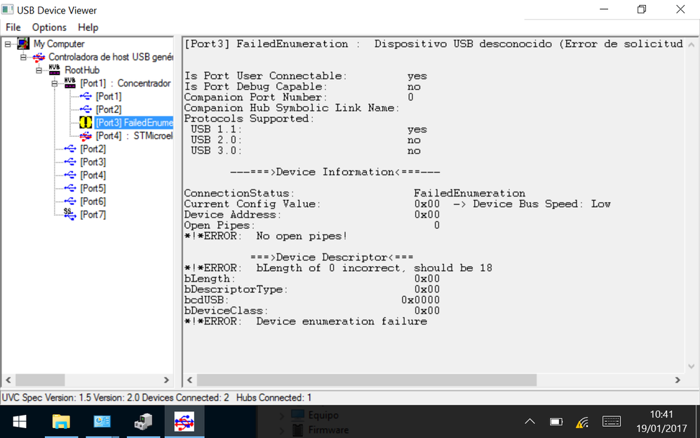

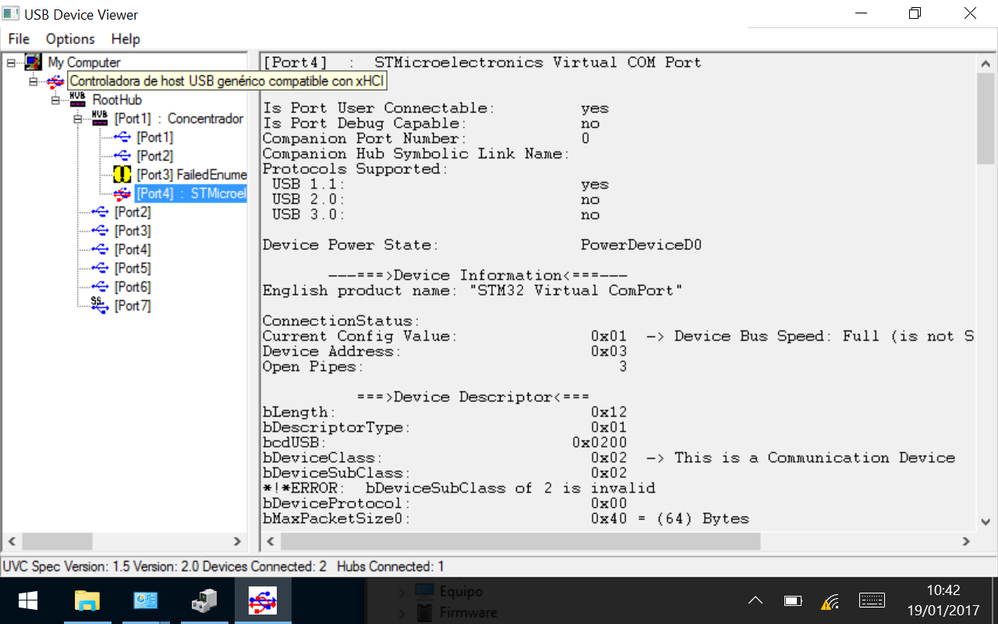

, I discard problems with the HUB and the possible exchange of D + for D-, and the problem persists. I've done captures with USBview to see what kind of problem I have.STM32F103 working fine:
Now the STM32F107, with the communication problems.
I have tested by placing the pull-up resistor at 107, but that way it stops working the
I created the software with CubeMx in both micros, so I imagine the problem doesn't come from here.
Thank you in advance.
