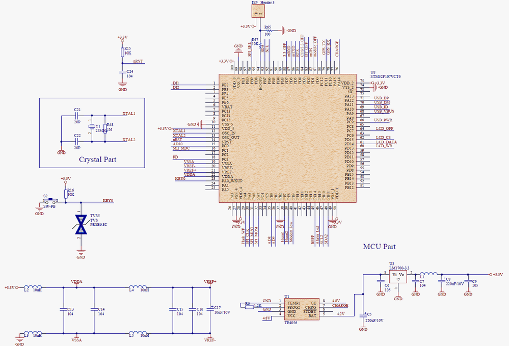

1.5% of products which use STM32F107 totally dead after using 3 months;
Problem:
The NRST reset not function. After disconnecting the power and connecting again, the chip could recover and work again. And this problem could not be reproduced in our lab condition.
information: the chip use STANDBY mode to shut down and use WAKE UP pin back to work.
The schematic is attached below.(Only the core components displayed)Is the schematic wrong or did I missed something?

Thanks for your response;
But I really don't think this is a software issue; I know well the issue about using more than one wakeup soure; According IO signals detected by myself, the chip stay in reset mode; The reset pin voltage is 3.3V, and it could go to 0.0V when I short the capacitor; Here is the code related init and standby routine.//Core init routine
