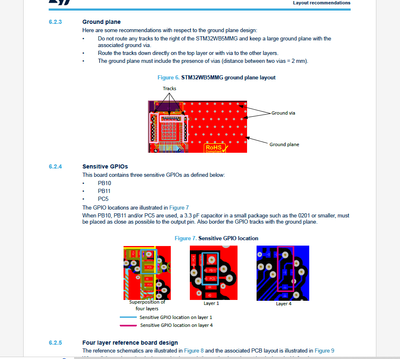

In the page 13 of the datasheet (https://www.st.com/resource/en/datasheet/stm32wb5mmg.pdf) there is limited information about the PCB layout guidlines.
I'd like to know more about the layout on left side of the module in the image shown if the modulle cannot be placed in the corner.
Also, what are the dimensions of the stitched ground plane on the right side of the module?
Is there a document which provides more detials about the PCB design guidlines?

I've had a look at that too. It uses the Stm32WB55 chip; my question is regarding the STM32WB5MM module which has an antenna inbuilt. I want to know more about the layout specs for the best antenna performance.

I am using the STM32WB5MMG module( STM32WB5MMG - Ultra-low-power Module - Dual core Arm Cortex-M4 MCU 64 MHz, Cortex-M0+ 32 MHz with 1 Mbyte of Flash memory, Bluetooth LE 5.4, 802.15.4, Zigbee, Thread, Matter, USB, LCD, AES-256 - STMicroelectronics) not the STM32WB55 chip alone. The WB5MM module has the antenna and oscillators on the module. I cannot place the module as the example in the data sheet and wanted to know more about the PCB layout specs for best RF performance since the internal circuit of the WB5MM module is not given.
