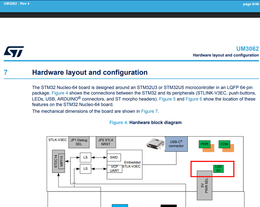

@senthilk wrote:
my LD3 flashes twices and then goes solid green
LD3 shows that 5V power is reaching the ST-Link, via the CN1 USB connection:
But power is not reaching the target MCU - so, as @Mike_ST said, you need to check the board configuration.
