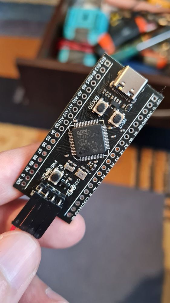

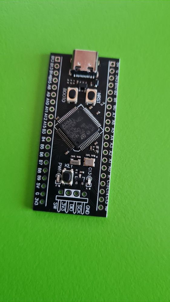

Hello.
I buy board STM32F401Development Board V3.0 STM32F401CCU6  .
Board workin and work usb, but me need can bus.
I replase  SMM32F401 MCU on STM32F105RCT6.
Board work and programming bun not work USB ((. DFU mode not work.
I searching difference USB between SMM32F401 and  STM32F105. Not found ((.
Please help do work USB on STM32F105.

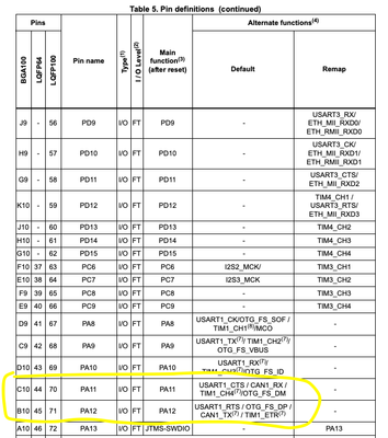

One more difference: 'F105 requires VBUS (+5V from USB, possibly divided down to 3V to reduce risk of damage) to be connected to PA9; whereas 'F401 does not require that, so it's probably not connected on the board.
Read relevant chapters in AN2606.

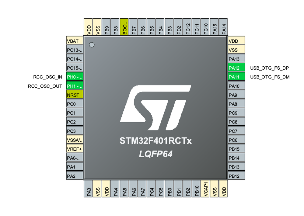

bithasher
Associate II
I watched. There are no differences.

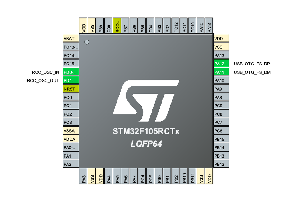

Show at least one difference in USBСнимок экрана 2023-09-29 в 20.52.20.pngСнимок экрана 2023-09-29 в 20.48.18.png
bithasher
Associate II
stm32f105rc

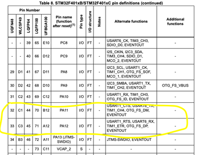

bithasher
Associate II
STM32F401CCU6

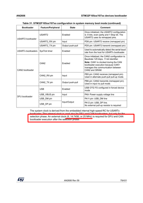

waclawek.jan
Super User
What crystal is on the board?
bithasher
Associate II
Instaled 25 MHz.
I changed it to 8MHz, still doesn't work.
And what does crystal have to do with it if the STM32F401CCU6 works. STM32F401CCU6 also requires crystal!
waclawek.jan
Super User
Yes, but 'F401 DFU bootloader can work from a much wider selection of crystals.

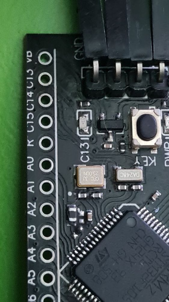

I don't quite understand how did you use a QFP-64 chip ('F105RCT) on a QFN-48 board ('F401CCU).
@waclawek.jan wrote:
Both MCU have packaging QFP-64.
Sorry, wrong link to Aliexpress ((.
105105401401
bithasher
Associate II
STM32F105RCT6 with crystal 25MHz
