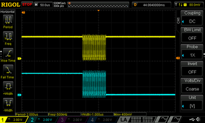

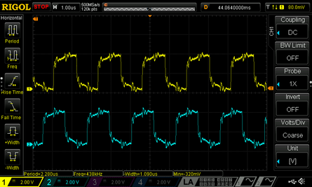

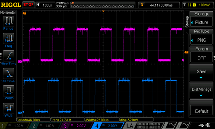

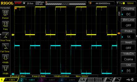

Reading from the scale (5v):
t
Output with HCLK at 4Mhz. DRO reads this fine:
Output with HCLK at 84Mhz. This is much cleaner than what I previously could get however the DRO still cannot read this:
My working theory is that the frequency of the last output is too high for the DRO to read. How can I rate limit this output to ~20Khz or so without setting HCLK to a lower value? Or is setting HCLK to a very low value an accepted solution?
