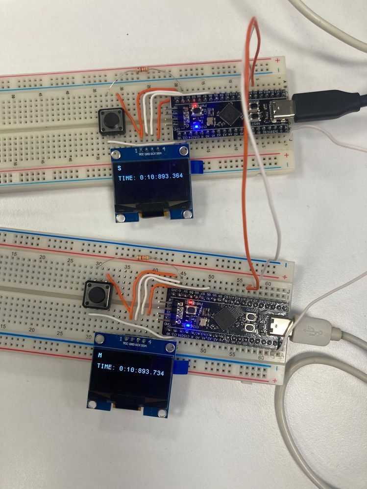

I am working on time synchronization between two identical Blackpill STM32F401CCU6 boards.
Both boards:
Use internal HSI oscillator
Same firmware
Same clock configuration
TIM2 configured as 1 MHz free-running counter (1 µs resolution)
32-bit counter (auto-reload = 0xFFFFFFFF)
Clock configuration:
HSI ON
PLL enabled (HSI → PLL → SYSCLK)
SYSCLK = 32 MHz
TIM2 prescaler = 31 → 1 MHz timer tick
Initialization
Synchronization Method
One board acts as MASTER
Other board acts as SLAVE
Communication via UART (115200 baud)
Master sends a 5-byte sync packet:
0xAA + 4-byte counter value
Slave receives and sets:
htim2.Instance->CNT = received_counter; Initial sync works correctly.
After synchronization:
Drift increases over time
After 30 minutes → ~2400 ms difference
This corresponds to approximately:
~1300 ppm difference between the two boards.
Both boards are identical and running the same firmware.
Is this drift expected when using HSI?
What is the typical HSI accuracy (ppm) for STM32F401?
Would switching to:
External crystal (HSE)
LSE
significantly reduce drift?
Is there a recommended method for long-term time synchronization between two STM32s without external clock sharing?
No hardware clock sharing between boards
No external crystal currently used
Only UART connection between boards, and removed after sync
I would appreciate any guidance on improving long-term timing stability.

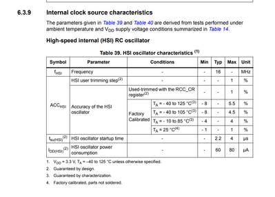

2026-02-12 8:00 AM - edited 2026-02-12 8:54 AM
Hello @TTT and welcome to the ST community,
Did you refer to the datasheet?:
This is is for an ST genuine chip (genuine STM32). I'm not sure what you have on that Black Pill board.
Meanwhile, if you are measuring the time in one second precision HSI is not the right clock source. You need to use a crystal and use it with RTC and LSE.

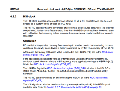

2026-02-12 8:10 AM
Thank you for your interest,
I refer for RM0368 Reference manual STM32F401xB/C and STM32F401xD/E advanced Arm®-based 32-bit MCUs, I can not find your table. I am not sure about the chip is genuine, and here the page of the board:
https://stm32-base.org/boards/STM32F401CCU6-WeAct-Black-Pill-V1.2.html
2026-02-12 8:14 AM - edited 2026-02-12 8:53 AM
There are two main documents for a product:
The user manual: mainly for the peripheral and register description. In your case RM0368
The datasheet: manly for the electrical characteristics. In your case DS9716 /Table 39. HSI oscillator characteristics
The errata sheet can also be considered a recommended document to refer to. It provides the limitations in the product as well as some workarounds of these limitations. In your case: ES0222
