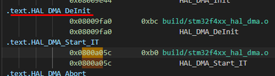

Sorry I meant its stuck in somewhere, is it possible to debug application code when using bootloader? I tried with bootloader now and I saw this error:
which means its in Hard Fault handler:
When I check call stack I see:
It fails in HAL_DMA_DeInit function. I was calling this function before initialization of DMA. I removed it.
After removing It keeps toggling LED but transmits data only once, then it doesn't send data (in the timer interrupt, I send test byte and toggle LED). Actually this was the my earlier problem, to solve it I added and removed many things (like HAL_DMA_DeInit ) whole day and forgot root cause. So I can summarize the issue: After jumping to application I send data with HAL_UART_Transmit_DMA function, data is sent once.

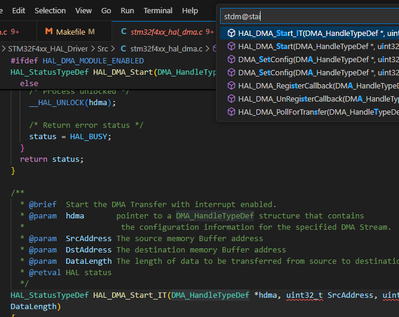

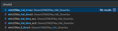

Sure CubeIDE finds files. In VS Code when you want to open a file, you are not writing whole file name, only a few letters is enough:
Then you can see outline by writing @ character and open fuction directly.
