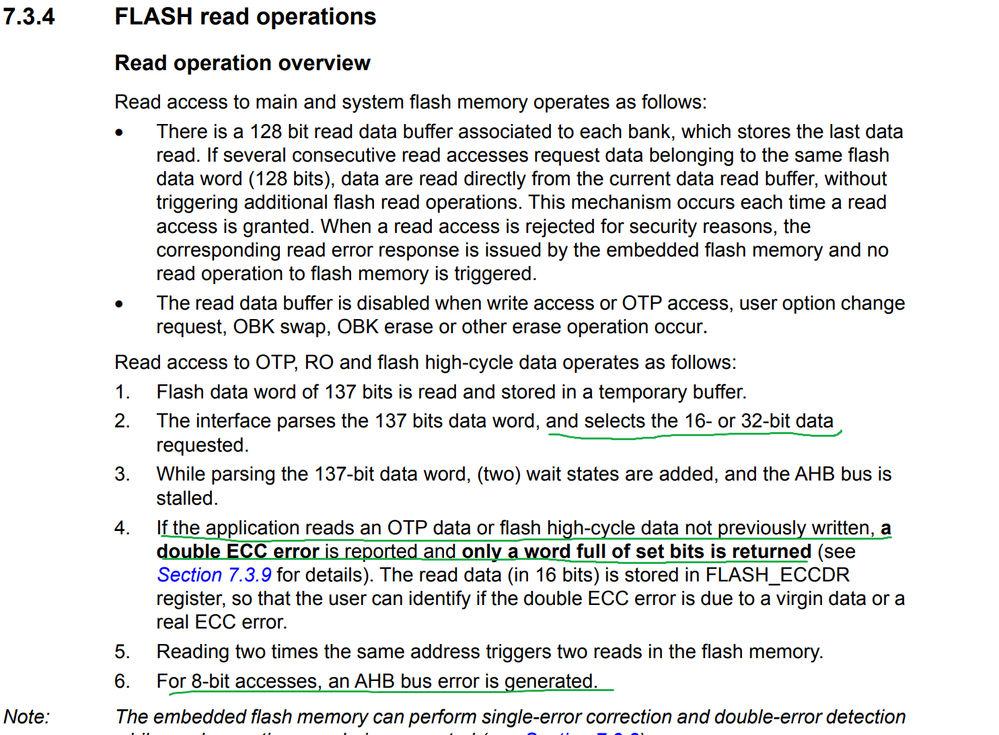

I'm using STM32H563 and managed to set FLASH_EDATA1R_CUR as needed (EDATA1_EN="1", EDATA1_STRT="111"). Then I tried to read 64-Bit at once from Address 0x09000000. Unfortunately I get a hard fault. Is it intended to read more than 16 bit from the high cycle memory?

Here is a screenshot from STM32H5 Reference Manual - Flash / Read section.    Reading High-cycle data is a bit special and only 16-bits or 32-bits access read is supported at once.
Can you please check if the content is already written or not ?  if it is virgin a double ECC error will trig as mentioned here.
Hope it helps you.
Ciao
STOne-32

thanks for the reply. No the data has not been written in this case, so I accept double ECC error, but this shouldn't trigger a hard fault, shouldn't it?
Is there any chance to verify the data via debugging probe (ST-Link v3) and the memory view or is this also complicated, because of the 16/32-bit read access?
