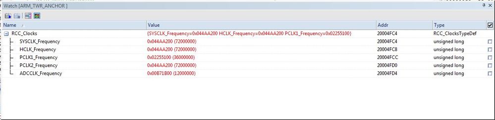

Unfortunately the code provided is incomplete, try to provide some complete context. You are using a specific board, cite some links or names for that. You specify you have a working .hex, where did that come from? Provides a cite. Perhaps the board doesn't use an 8 MHz crystal and thus the timing assumptions are off? I'd front check for TXE rather than back check for TC. Do you have a debugger? Can you use that?2016-06-08 5:08 AM
2016-06-08 5:30 AM
Are the baud rate settings identical (start/stop bits, parity) ?
A scope is recommended, to check that the outgoing signals actually have the assumed baud rate.> Perhaps the board doesn't use an 8 MHz crystal and thus the timing assumptions are off?That is an often recurring reason for the baud rate being off.
2016-06-08 5:34 AM
2016-06-08 5:42 AM
The system clock is conveyed via HSE_VALUE define, the PLL settings will also need to change. Some debuggers can provide a peripheral view showing configuration settings.
One could also send a stream of 'U' characters and confirm baud timing with an oscilloscope. Internal clocking could also be check by programming PA8 in MCO mode.2016-06-08 5:43 AM

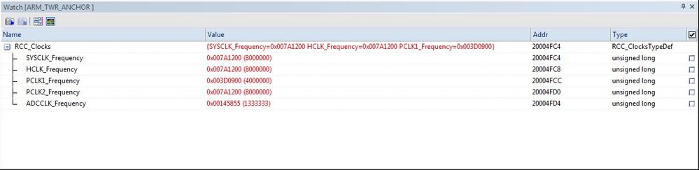

I've modified the code in this manner and for me the oscillator is an 8Mhz. Other ideas?
