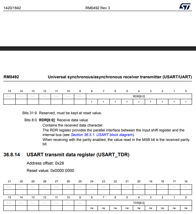

@Bob S wrote:if you want to send 1 byte you need to write 1 byte, not a 32-bit value
Well, the USART TDR register is a 32-bit register:
Right-o, I was thinking of the SPI data registers, that can take 8/16/32 bit writes.
