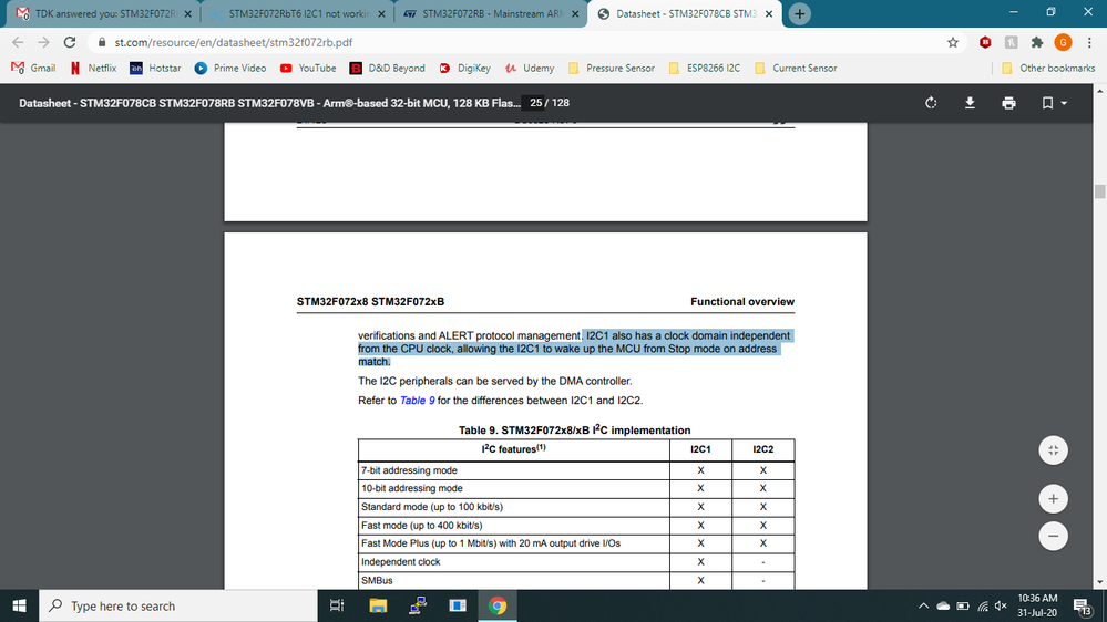

I feel it has something to be with i2c1 being used to take MCU out of the STOP condition. I'm not sure how to go on about it since I'm new to this.

2020-07-30 10:19 PM
I was looking through the datasheet and found this. Maybe I wasn't able to put in words properly about i2c1 being used to reset MCU.
