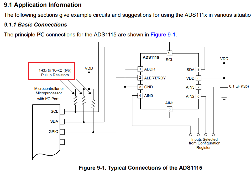

Your issue is more related to the external ADC ADS1115 which is not ST product.
You said:
Pull-ups initially were 12 kΩ to 5 V
But in the ADS1115 datasheet. the range is 1K to 10K:
