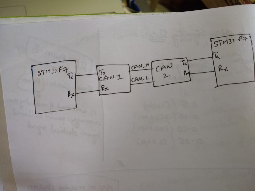

The filters look okay to me. How are CAN1 and CAN2 connected, with PHYs?
The _1TQ timing look like defaults. Have you calculated it like with http://www.bittiming.can-wiki.info/
2020-07-16 12:39 AM
CAN1 and CAN2 are connected physically with jumper wires and i am using cjmcu230 canbus module. i changed the bit rate to 100kbps its transmitting perfectly but at reception side it is entering into Error_Handler(); .
