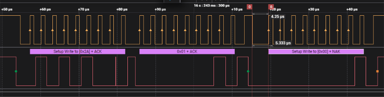

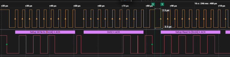

Here is an example of a correct signal:

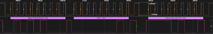

The signal with error and I2C_Flush_DR() looks like this:
static void I2C_Flush_DR(I2C_HandleTypeDef *hi2c)
/* Write a dummy data in DR to clear TXE flag */
if (__HAL_I2C_GET_FLAG(hi2c, I2C_FLAG_TXE) != RESET)
hi2c->Instance->DR = 0x00U;
} The signal and I2C_Flush_DR() looks like this:
hi2c->Instance->DR = 0xF4U;
} As you can see, this happens because I2C_Flush_DR() is called at the wrong time, but I don't know why. The slave address should be written to the DR register, but the value from I2C_Flush_DR() is written instead.
