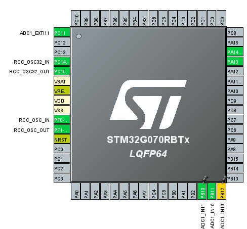

maybe i am thinking wrong but you can use the PWM signal for the trigger? with the rising edge so the conversion is almost instan after PWM tigger? In my case (STM32G070RB) it will use the EXT11.
