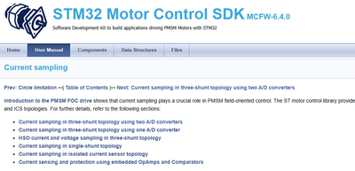

The phase current sensing is described in the MCSDK 6.4.0 user manual
According to me 2 ADC channels are read simultaneously for 2 phase currents and the 3rd one is derived, which 2 phase currents to be read depends on the duty of the PWM.
